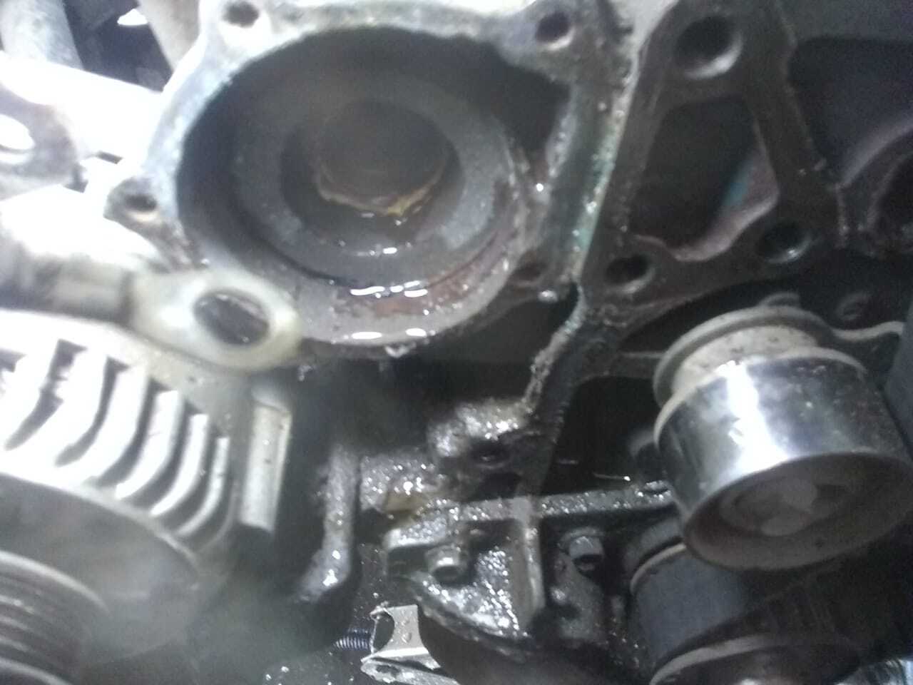

After welch plugs change & soda flush about 8 weeks ago, 4 days ago i noticed cooling fan taking too long to turn off. started to look from electrical issue pulled out fan relay insert was ok relay had caramel brown legs appears bad so changed to new item cost Rs. 300

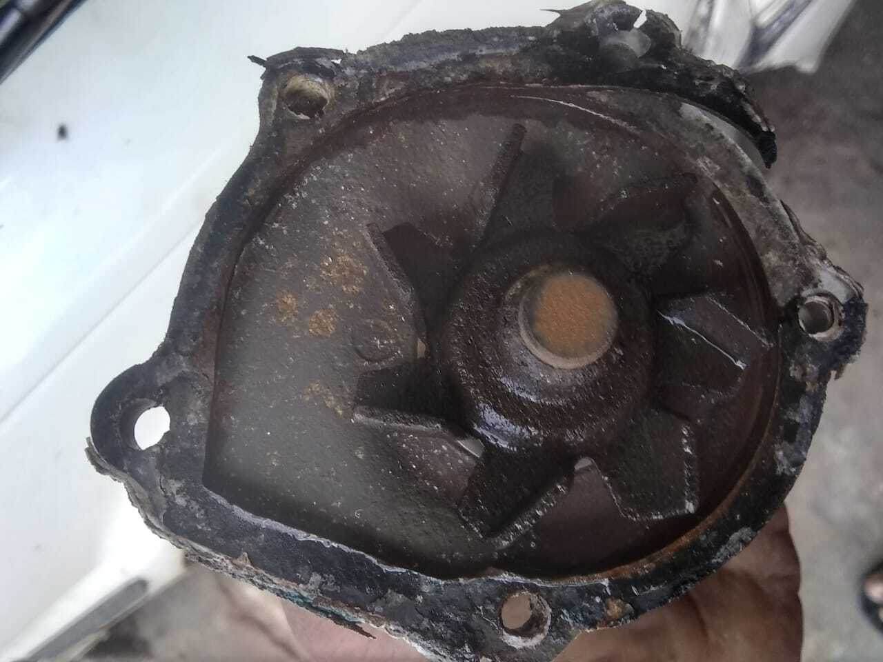

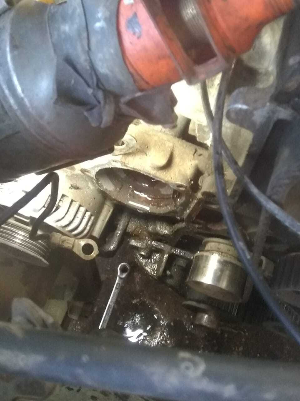

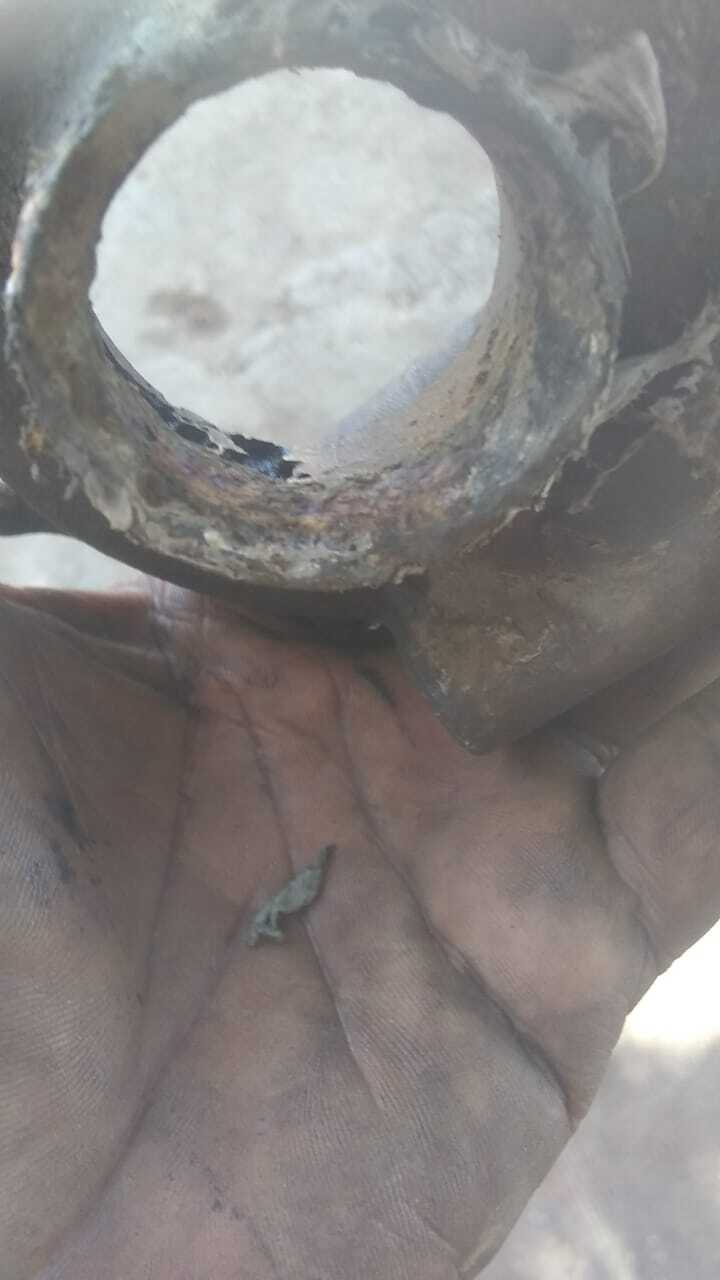

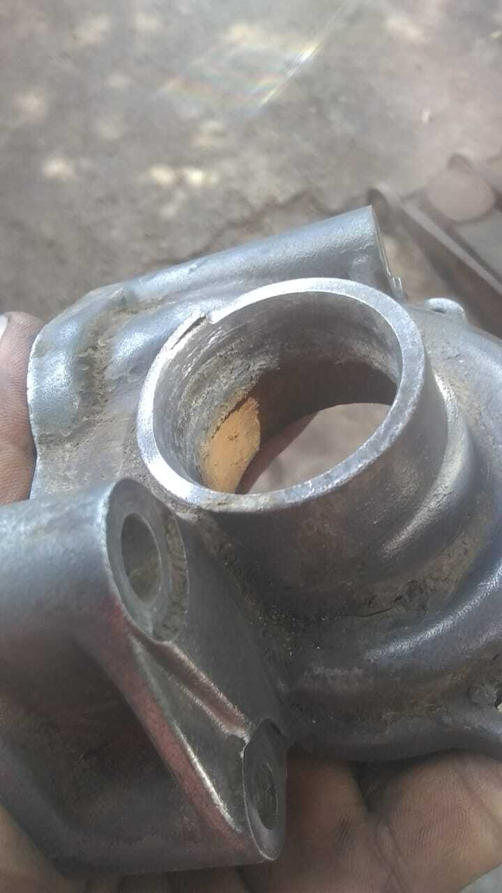

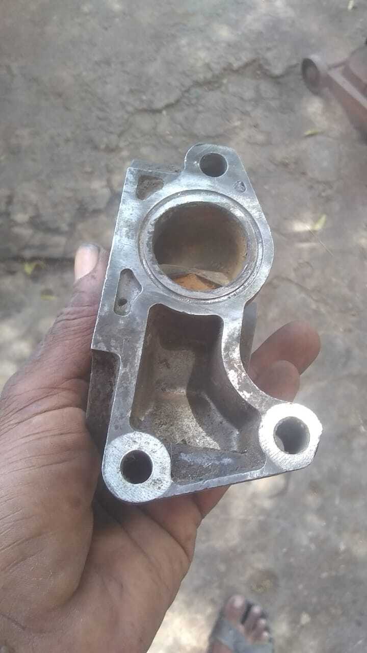

Changing relay did worked but the temp needle started bit erratic behavior so started to investigate deeper, checked for hose clips. Topped up expansion bottle couple of times and it turned out to be overflow from bottle. checked for radiator cap and it was new had not issues earlier. I was seriously confused for whats' wrong why temp needle move bit up in crawling traffic.

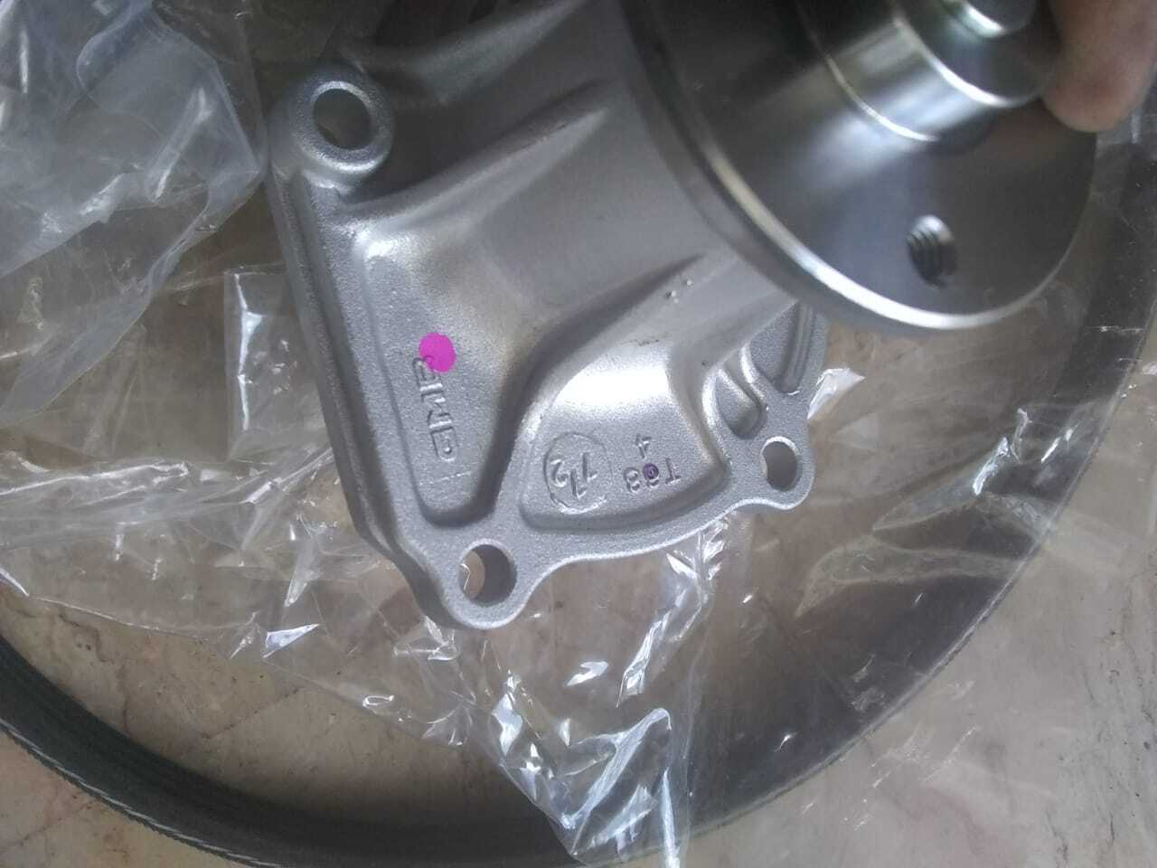

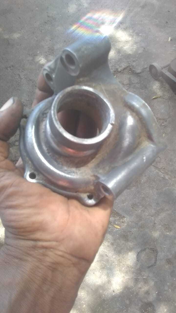

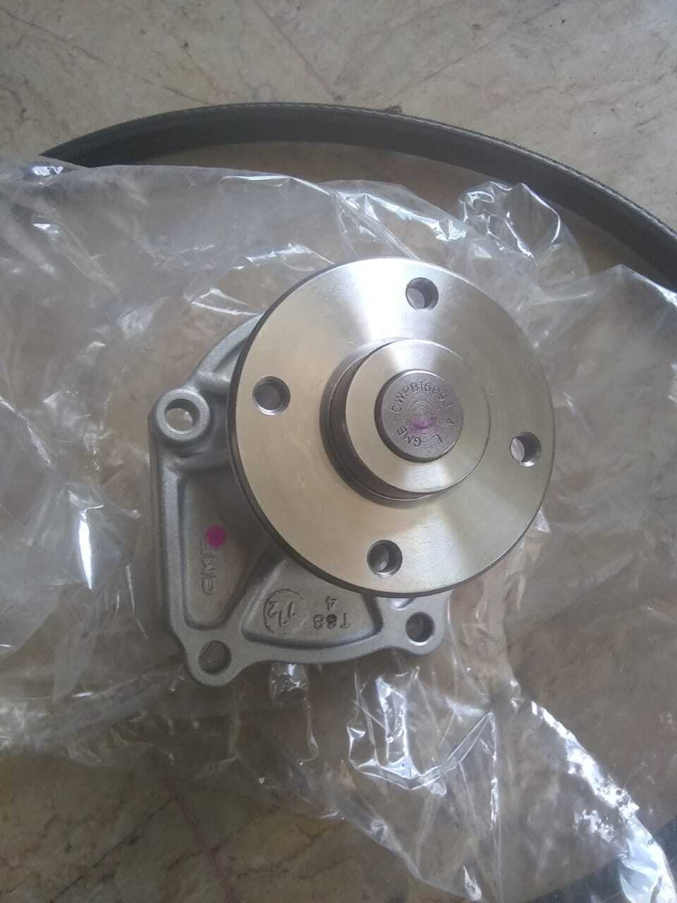

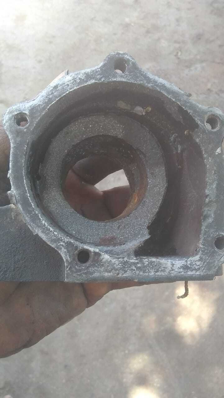

finally i did the idle run test at home in morning , culprit was located as pump leaking causing cavitation in system and expansion tank throwing up.
here is pictorial of situation.

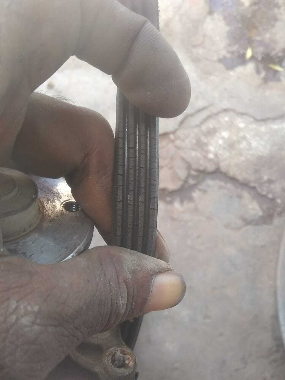

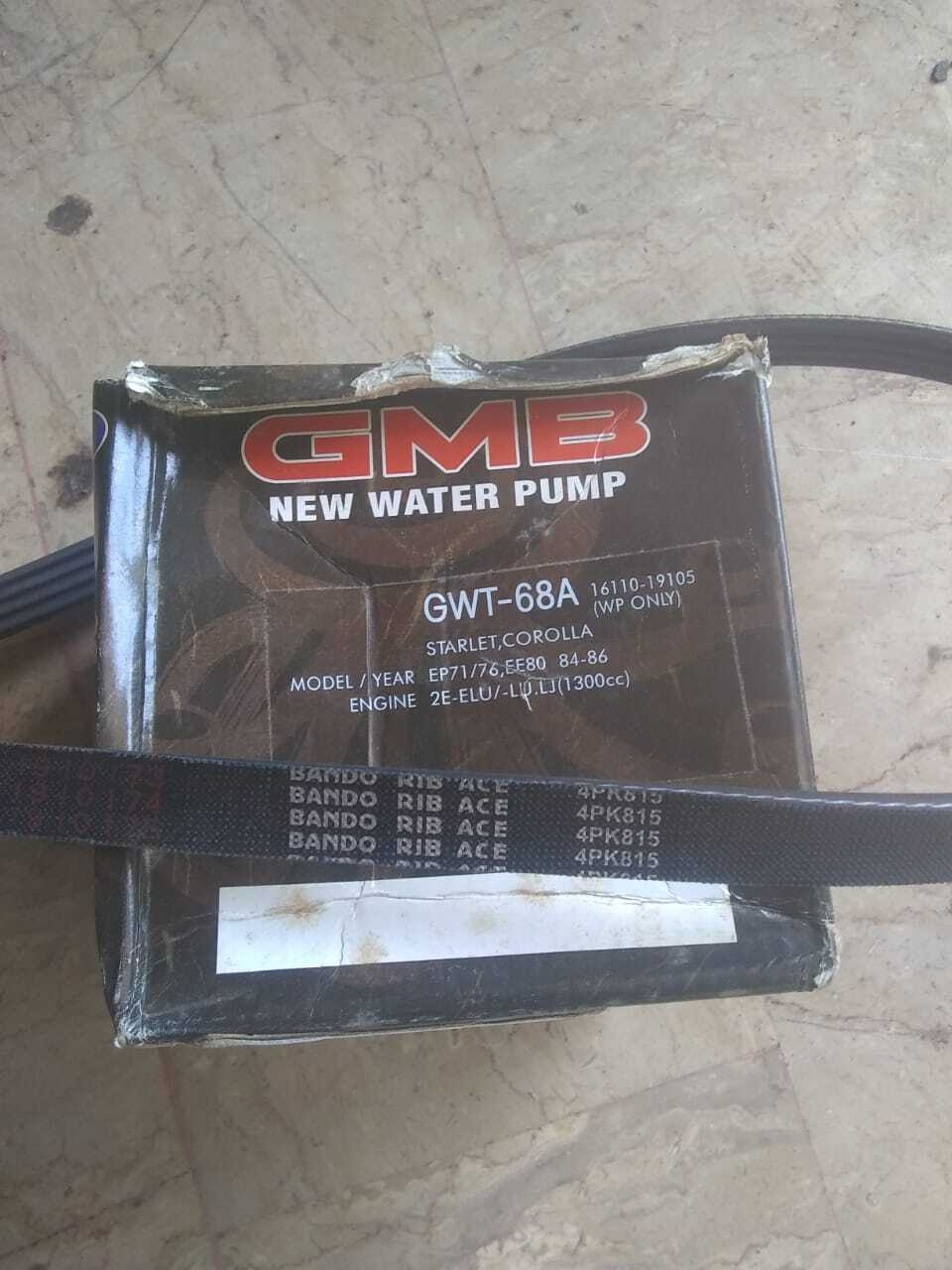

BELT was bad as well

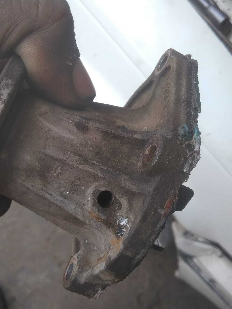

pump impeller was not so bad, but the flange housing was at end of life.
