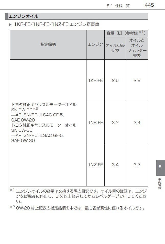

Please find attached the owners manual.

0w-20 is listed as the first choice and the last line says it is the most fuel efficient engine oil (use Google translate).
Why go thicker? No benefit of thick oil. It won't damage the engine of course but still I don't see any benefit of it.

I am talking about the recommended oil grades, not the most fuel efficient. Both are fine. I am presonally using w30 from the last 6years, previously had 1kr passo, and now 1kr vitz. Found no issues so far with both the performance and fuel efficiency
No where in the table is it specified. Anyways my point of discussion is nothing wrong in using w30 grade as i have been experiencing it from the last 5 to 6years, so far so good
But it’s not the optimum grade, and reduced fuel efficiency like it can be seen in your case. You’re not getting the right mileage.
