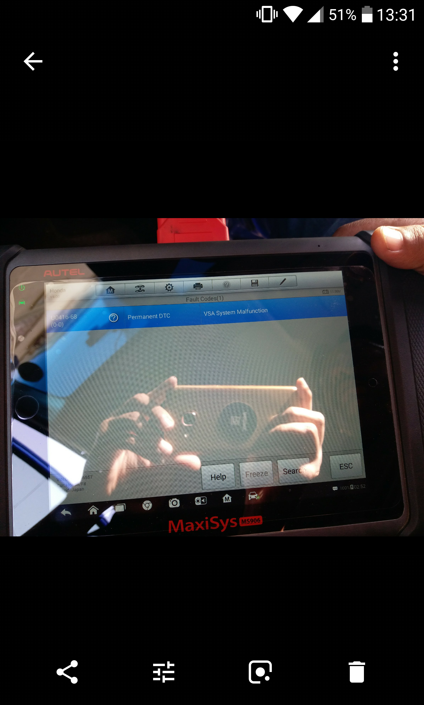

I am getting ctba system failure error on my honda fit 2014. This is the 3rd time that i have got this error previously i had taken the car to the mechanic who used the scanner to check for errors and found VSA,electronic power steering(EPS) error and i have attached the screen shot of these error and also the ctba error on the intrument cluster. Could any one who has got the same error or someone who has some knowledge about this tell me what could be the problem. Is there something wrong with the car's braking system,vsa or something else and also how would i find out what is the fault as most of the mechanics in karachi dont know anything and they just reset the error.

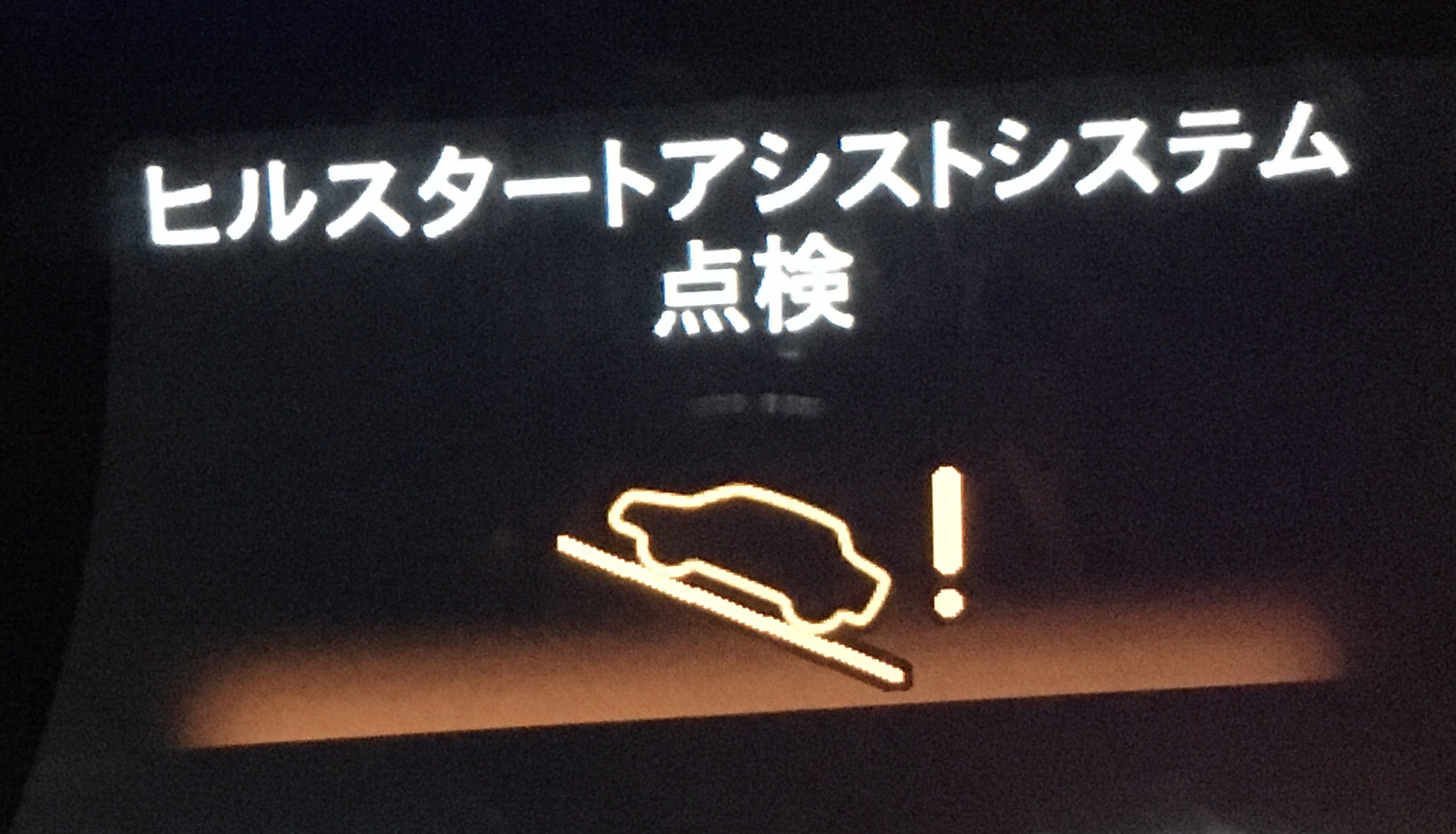

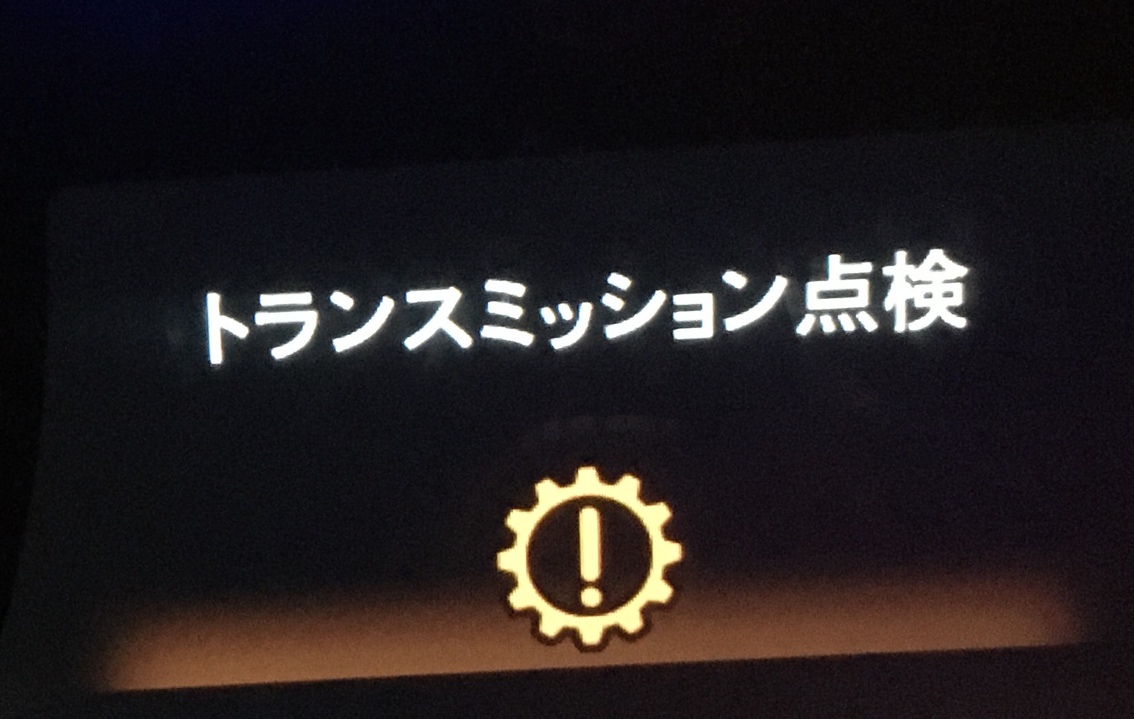

But today a few more errors showed up. I’ve attached the pictures for reference. I stopped the car to restart. But I couldn’t select drive or turn my steering after starting again.
Also I forgot to mention when the CTBA error shows up, the gear indicator in the dashboard starts flashing.
I stopped
Looks like your battery under the bonnet is weak or not charging properly, try replacing that first after confirming that it is actually faulty.
If that doesn't fix it, then the gearbox may actually be the issue. However, first check the wiring connections from the gearbox all the way to its control unit. Sometimes the issue is simply a loose connection or dirt/grease that doesn't allow electricity signals to flow properly. The symptoms you are describing point to an electrical issue rather than a mechanical one, so hopefully you won't need a replacement gearbox.

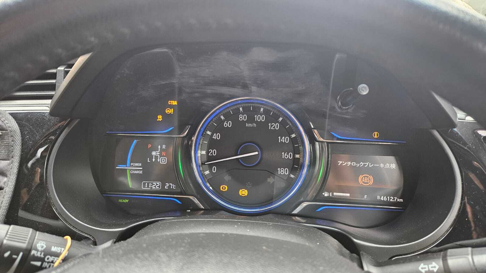

That doesn't sound like a gearbox issue. You need to get this checked out by a mechanic with a scanner. These lights are for CTBA and ABS unit. Engine also seems to be under intermittent load, maybe bad spark plugs or coils. Either way, get it checked from a good mechanic - if you are in Karachi I can recommend a couple of workshops.
