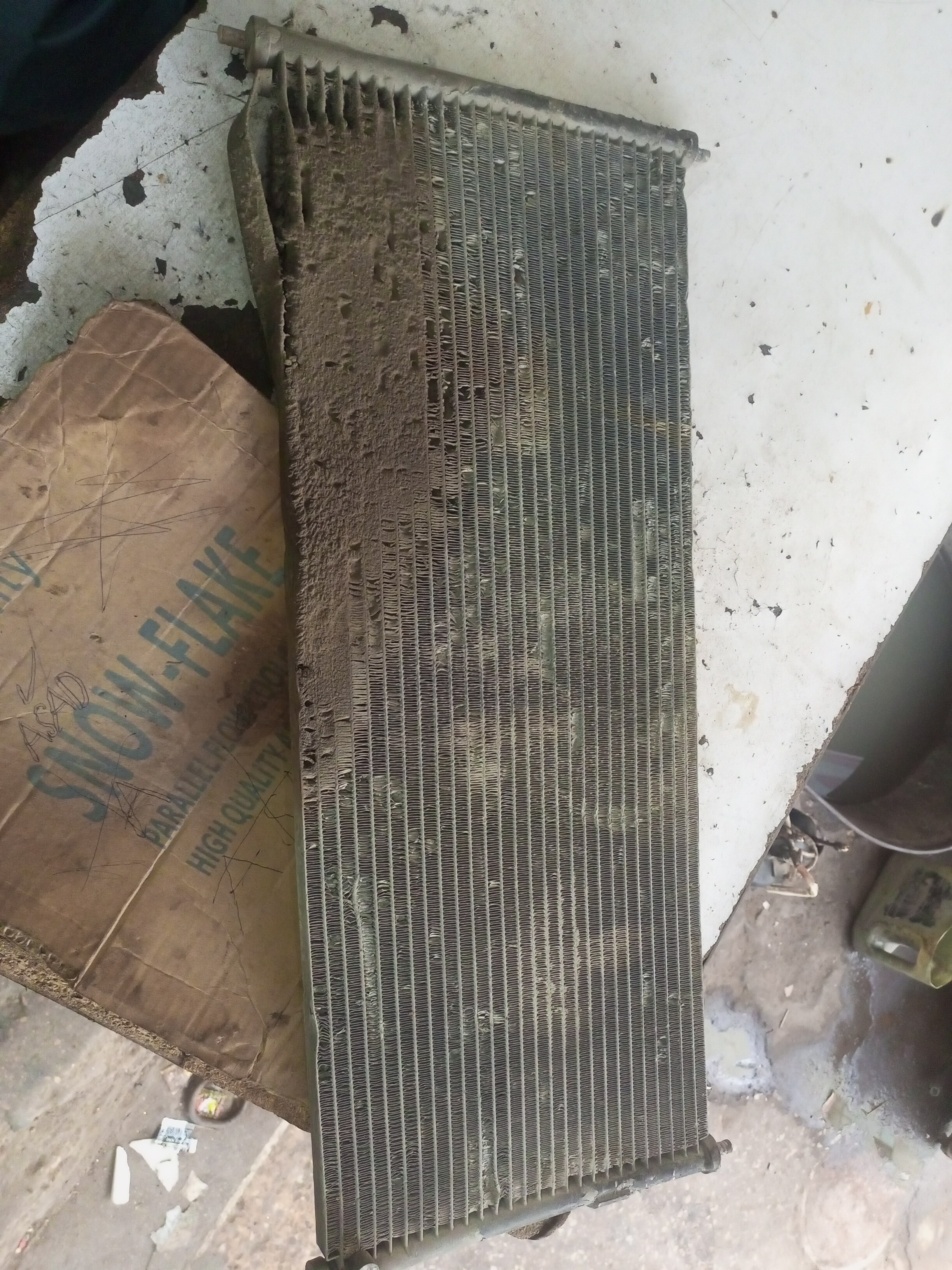

I have a Honda City 2001-2 EXI-S Automatic. The Issue I am facing is that in the last 3 days its AC compressor has released the refrigerant/gas thrice. The cooling before it released gas was amazing all three times, it always happened after 25-30 mins of drive, car's temperature was fine, no overheat, radiator is new, fans are working so no heat up.
The desi AC mechanic is saying compressor is done, it gets heated up after 25-30 mins and then releases the refrigerant. Now I know the compressor is weak as cooling is a bit compromised and I have no problem in getting it changed, but I want to be sure first that it's compressor which is the culprit behind this all.
What I personally know a little bit is that it might be happening due to pressure getting too much in the compressor or high pressure line, but as far as I know there is a high pressure cut off switch that should trip my AC before releasing gas, but the AC mechanic says there is no such thing on any car AC, but I have read about it everywhere.
Personally I couldn't see any such switch on my high pressure line, can anyone confirm about it and guide me what's the problem here?
