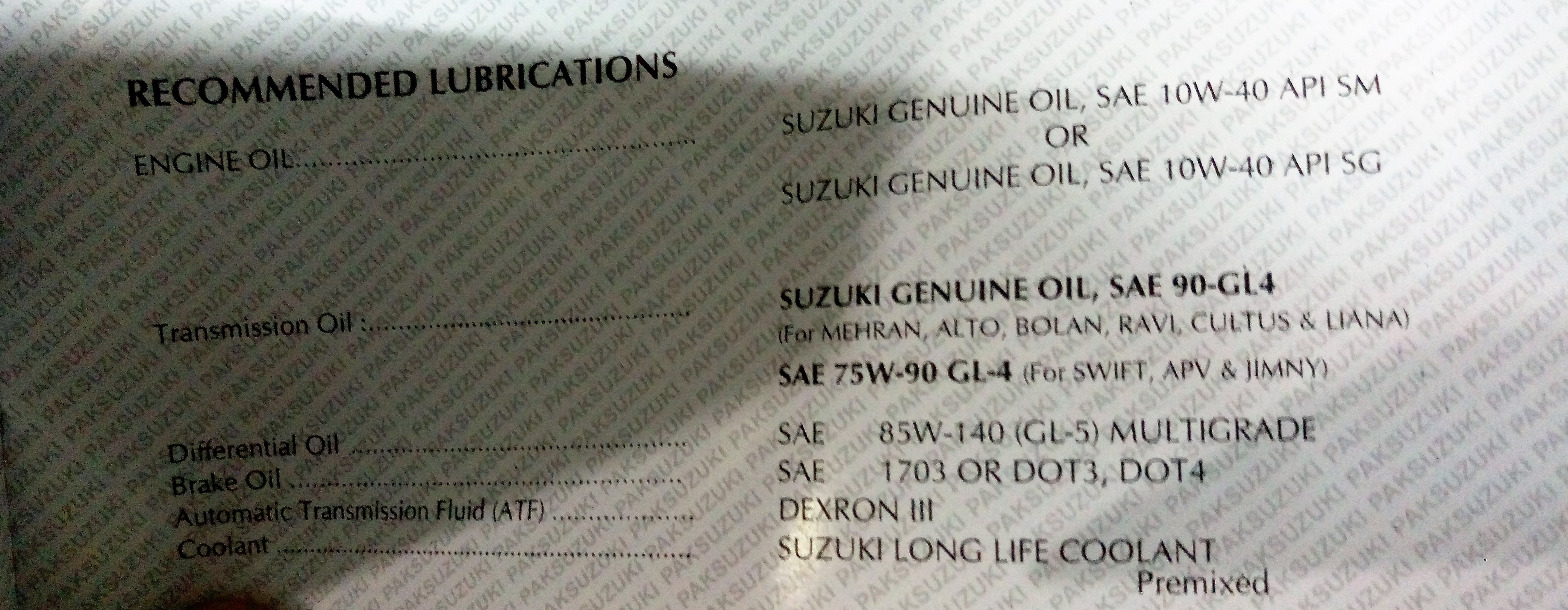

I am about to change my swift gear oil first time @ 5000 km.
Please suggest easily available and good quality gear GL4,75W-90 gear oil in Karachi.
I have seen ZIC 75W-85 gear oil available on ZIC Pakistan website , is this suitable to use instead of 75W-90? Please advise.

zic and kixx both are fine
you can use 75w-85 instead of 75w-90 due to very less difference in temp band
Gear oil at 5000 kms is weird just changed my corolla's gear oil at 40000 kms as per the manual
Suzuki likes to take whatever advantage it can have, so living in pakistan, do as the pak suzuki do
Suzuki change first gear oil at 5000.they will use their SGO gear oil which is not multigrade. They have only 75w. Where as manual says it should be 75w90. Also Suzuki gear oil is very thick. You will feel the gear hard specially in low gear
I initially used Suzuki gear oil at 5000 km for my swift. But changed to liqui Moly synthetic gear oil at 10000 kms. Gear is buttery smooth now

would you please share the page mentioning change Transmission oil at 5000 kms ...Thank you
