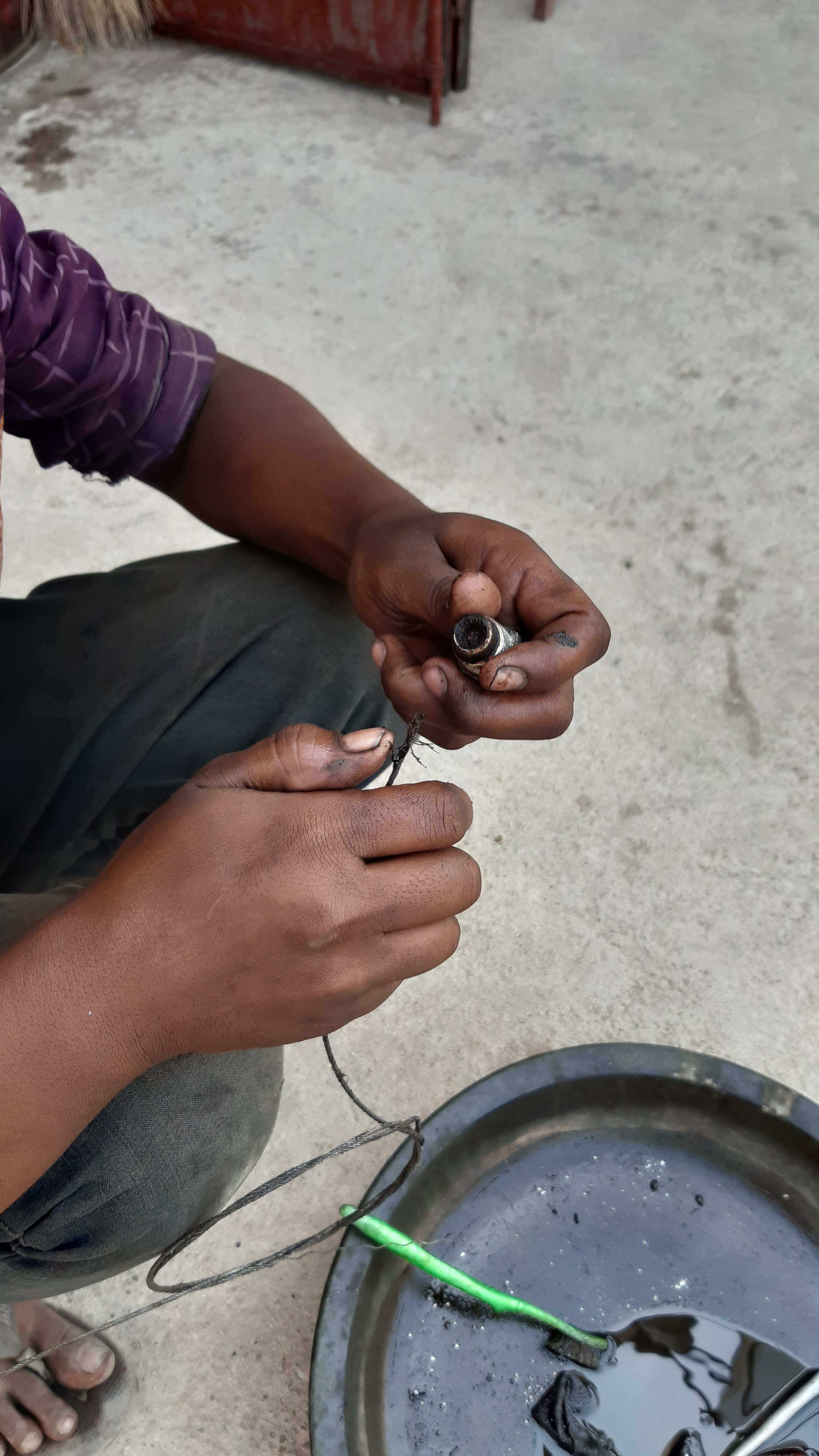

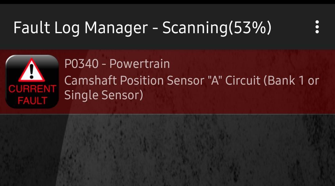

Remove the sensor and see if its dirty, sometimes metal particles/gunk sticks on the sensor causing errors which can be resolved with just a gentke wipe with cloth. Is it two wire type or 3 wire?
Bro i am not sure if its 2 or 3 Wite its Corolla, never took out that Sensor, i can do like this, i can take out Clean it and put it back then. and see if its solve the issue. if not then will replace the Sensor. last month my CRANKSHAFT Sensor was also Failed and i changed that too.
I just cleaned and install it again nothing happened, the Wiring is okay , Sensor was dirty i cleaned it but its showing same Check Engine light and Error, will Replace the Sensor now
dont clean it with solvents - just wipe it with cloth, never clean it with sandpaper either.
If its not resolving the issue, replace with good known sensor and retest.
Yes brother, i cleaned it with Soft Cloth and then put it Again but nothing happened, its not working fine, the Light is there and Delay in Starting long Selfing.
I will replace this Sensor tomorrow.
