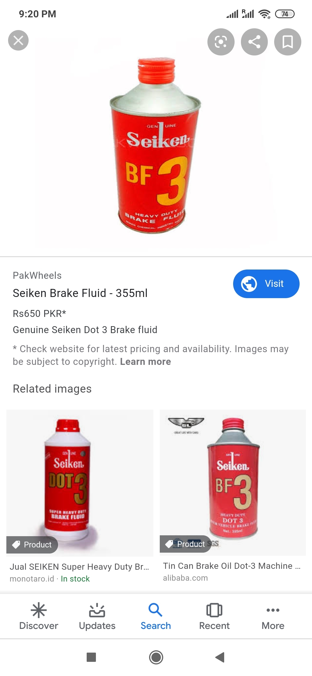

Tell me the order in which I should bleed the system and which brake oil should I use? If somehow i break any one of the four bleed nipples, can it be replaced?

Dot 3 sieken.
Outstanding hai.
380-430 kay bechmein ek can milta hai uska. I've tested it on many cars, kafi high quality hai

Gave my car to my trusty old mechanic today, he called me after 30 minutes and told that the master cylinder is past its expiry date. Got a it changed, bled all the black sludge from the brake lines and put in new Seiken brake fluid. Never knew this car could stop like this. :hushed:
