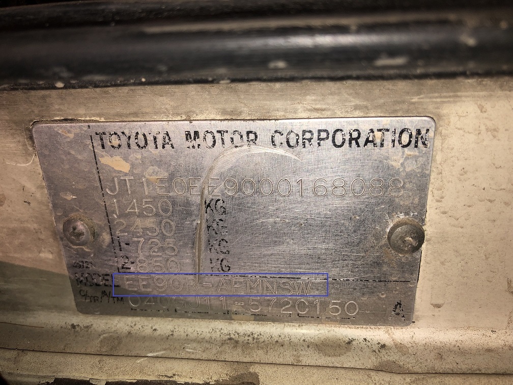

please share vehicle ID plate read able picture to identify trans/axle type & engine variant.

i still request to share the picture of vehicle id plate in engine bay to suggest something fruitful
