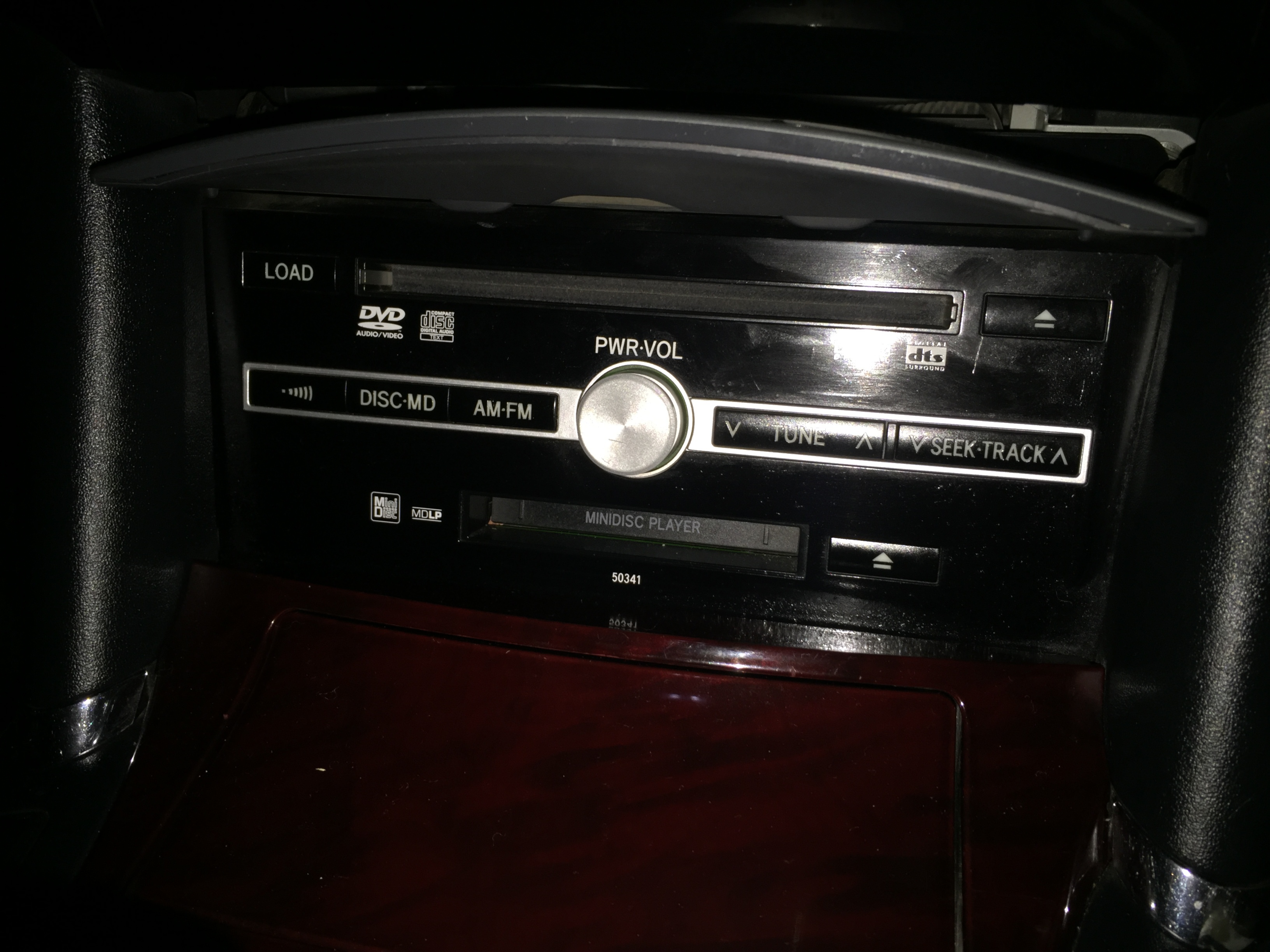

Yes this is the player that came with the 2007model which got the new interior. Is your car 2007 model or the player is changed?

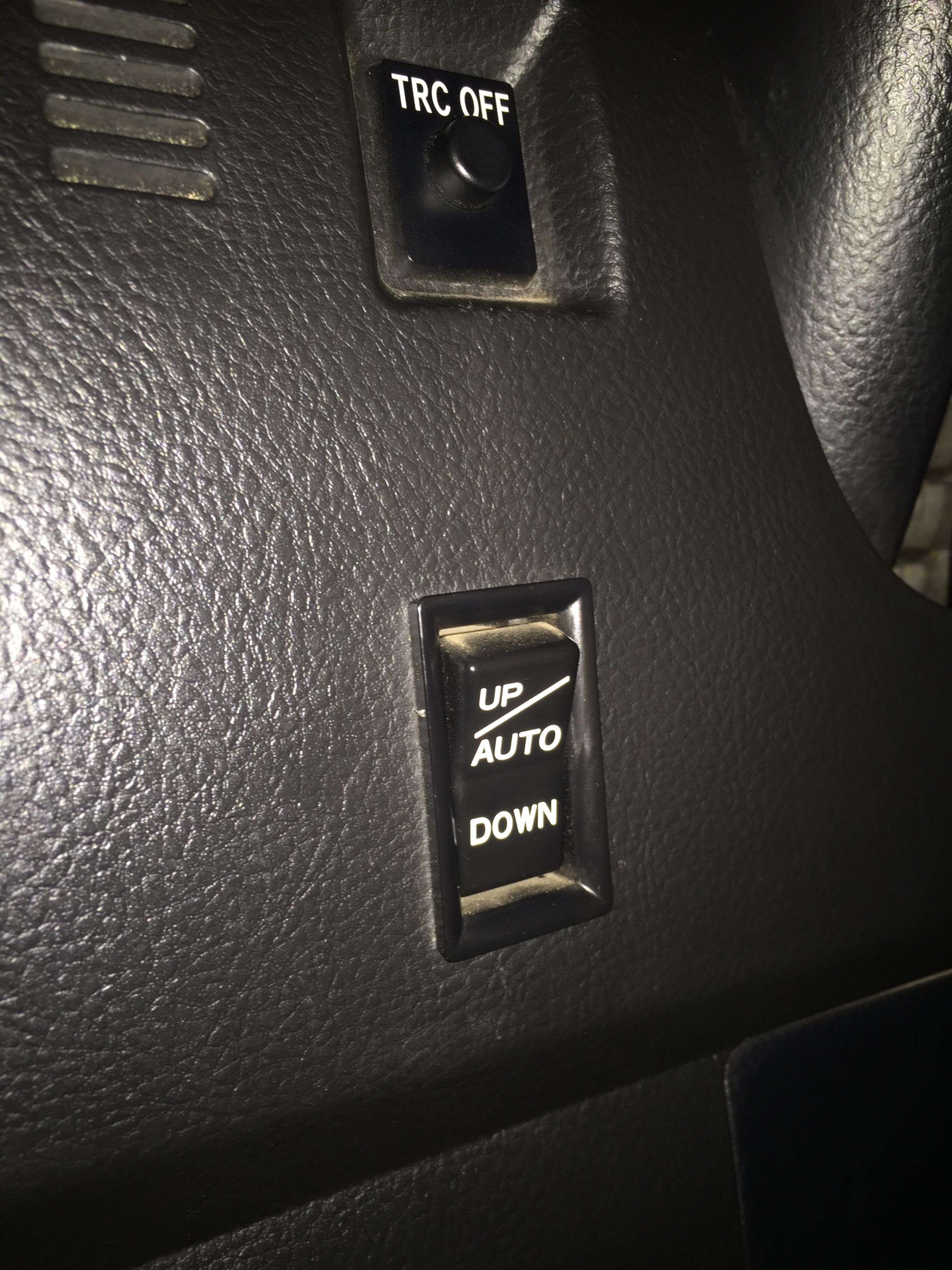

Brother mine is with electronic shocks and height adjustment. Plus parts are always costly if you buy them from Toyota but you can always get them from authentic sellers on Montgomery road.
I guess its 2006 or 7 maybe will have to check the book but no luck putting in DVD's

I think its better to get your sound system checked by an expert to know why its not playing dvds. If your car does not have a side turn indication bulb on its fender then its the one with new interior
Height adjustment??According to my knowlegde The sport suspension button does not adjust the height of the ride. It just stiffen ups the shocks.
Brother kindly do show the mechanism of the height adjustment feature in your mark X It must be a rare option to find as most of us have seen cars with electronic shocks and a normal/sports button in the interior

It does have a side turn indicator and its a 2006, I guess the auxillay cable the previous user used Is cliped to video output from the back.
are you sure this is for height adjustment ?Please examine by looking physically to confirm ?
Bhai this is not height adjustment this button is for curtain in the back and please also note that mark x in it's life span does not came with a height adjustment After market products are available
lol brother theres a separate switch for back shade.
I've downloaded the original manual which is in Japanese, when translated in English it does show an option of height adjustment but unfortunately nothing is happening from that switch. It's not height adjustment though.
Bro this button is for auto pole i.e an antenna on the corner of your front bumper which helps you in parking your car. Bassically it works as a parking sensor. When you put the switch in up position a pole will come out and sense objects nears you.
Oh yes, right brother. It does have an antenna on the bumper which is broken unfortunately..
