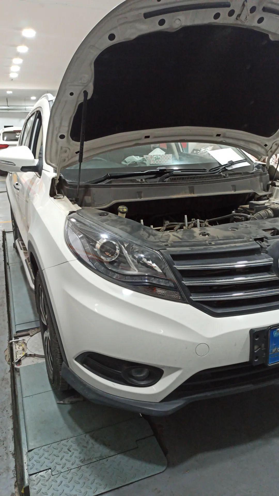

My Glory 580 pro is missing sometimes with check engine light and sometimes without, especially once i turn on AC. I am in Quetta and don’t have any dealership here, so i went to KIA they check the ecu and told me that both camshaft sensor are not functioning properly. I called some a dealership in karachi they asked me to buy new one for Rs 20000, isn’t it company’s responsibility to change it? Any one to please guide me a solution.

I have a missing problem with my 580 Pro. It's 2021 model, 9000 kms driven. The car does intermittent missing when you press the gas pedal. Sometimes it happens once in a drive , sometimes 5,6 times. When you press the gas pedal it starts knocking, vibrating, no acceleration. It doesn't go away if the pedal is kept pressed down. You have to release the pedal and press again then it goes away. I have went to the dealership twice and they were unable to resolve.
Visit dealership, get your car scanned, they will check for fault codes and then do the required maintenance. From the limited info that you gave here, it seems your CAMshaft position sensor might be faulty, it will be replaced under warranty for free, but you'll have to visit dealership and get DTR raised (Defect Technical Report), only then company will approve warranty claim and issue parts free of charge.

I have same issue with my Glory 580 pro, Last week while I was on Motorway its Engine Check light turned ON, I went to dealership in Islamabad and got the car scanned, it showed "Knock Sensor" problem, but the person at dealership said this is first time we have seen this error it cannot be knock sensor issue, and recommend to change the spark plugs and reset the check light. But unluckily the very next day same issue appeared again without the engine check light ON as it was normally happening before. My query is this issue has something to do with Knock sensor. Also bro tell me your car problem resolved ?

Not yet. Where are you from? I recently got oils and filters (Air, Fuel) changed. Changed spark plugs to Bosch. Engine Oil to Liqui Moly. Missing is still there. It does missing with Hi-Octane as well.
Didn't get the camshaft sensors changed because no check engine light.
