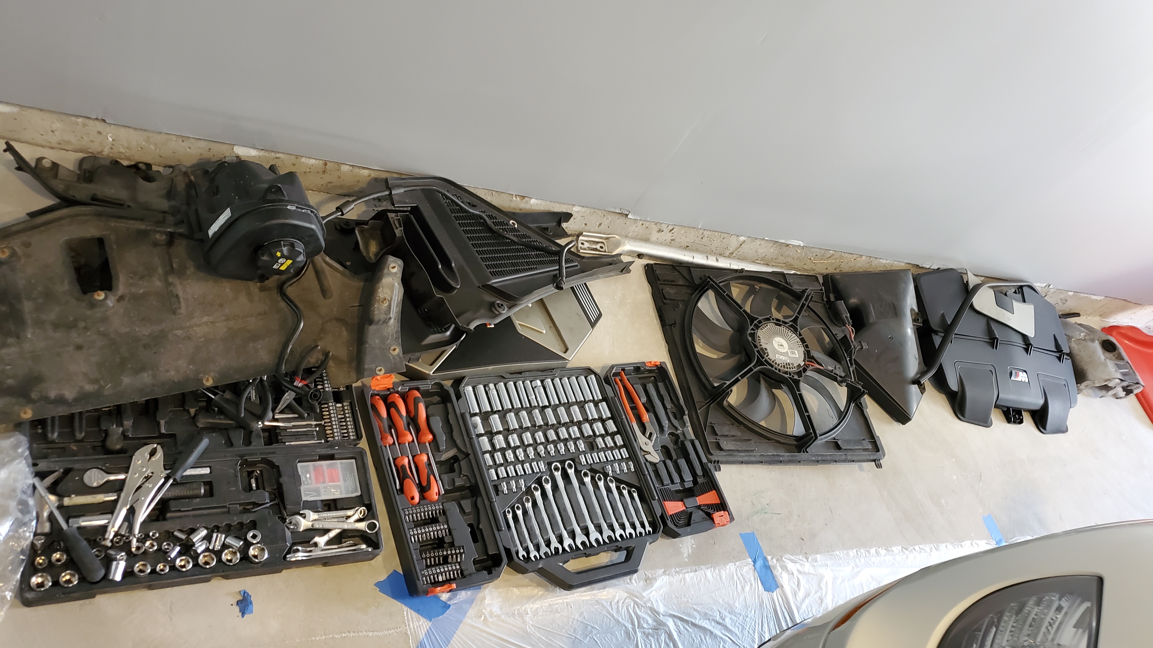

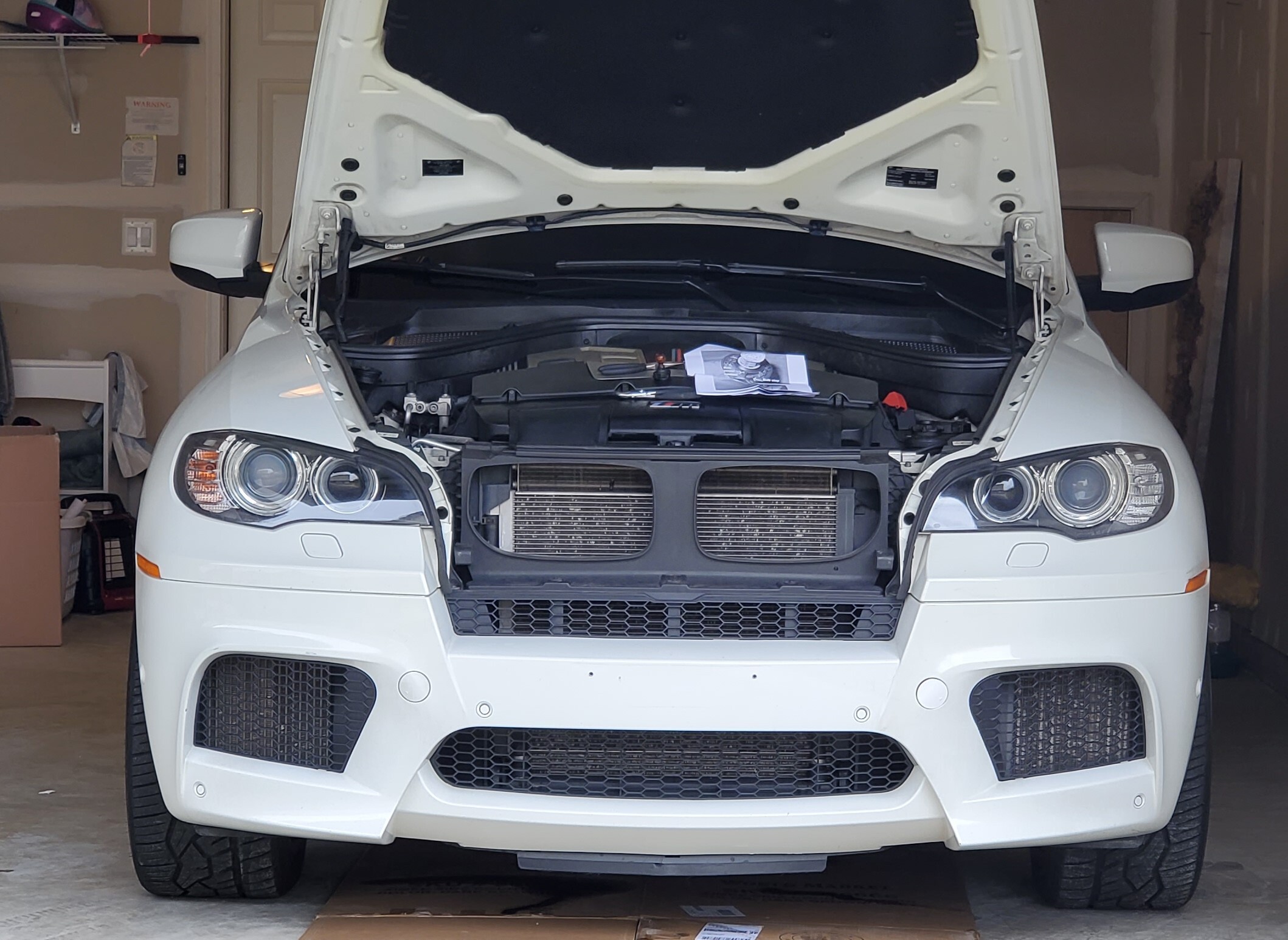

My car also smoked after longer idles but it was considerably improved after CeraTec and Oil Saver, and I'm replacing Oil Separators (within the valve covers) that are known to be another cause of smoking (if one of the CCV line breaks, oil separators tend to fail doing their job - separating vapor from the oil) - I plan to do a Oil Catch Can setup DIY once I'm done with valve covers.
