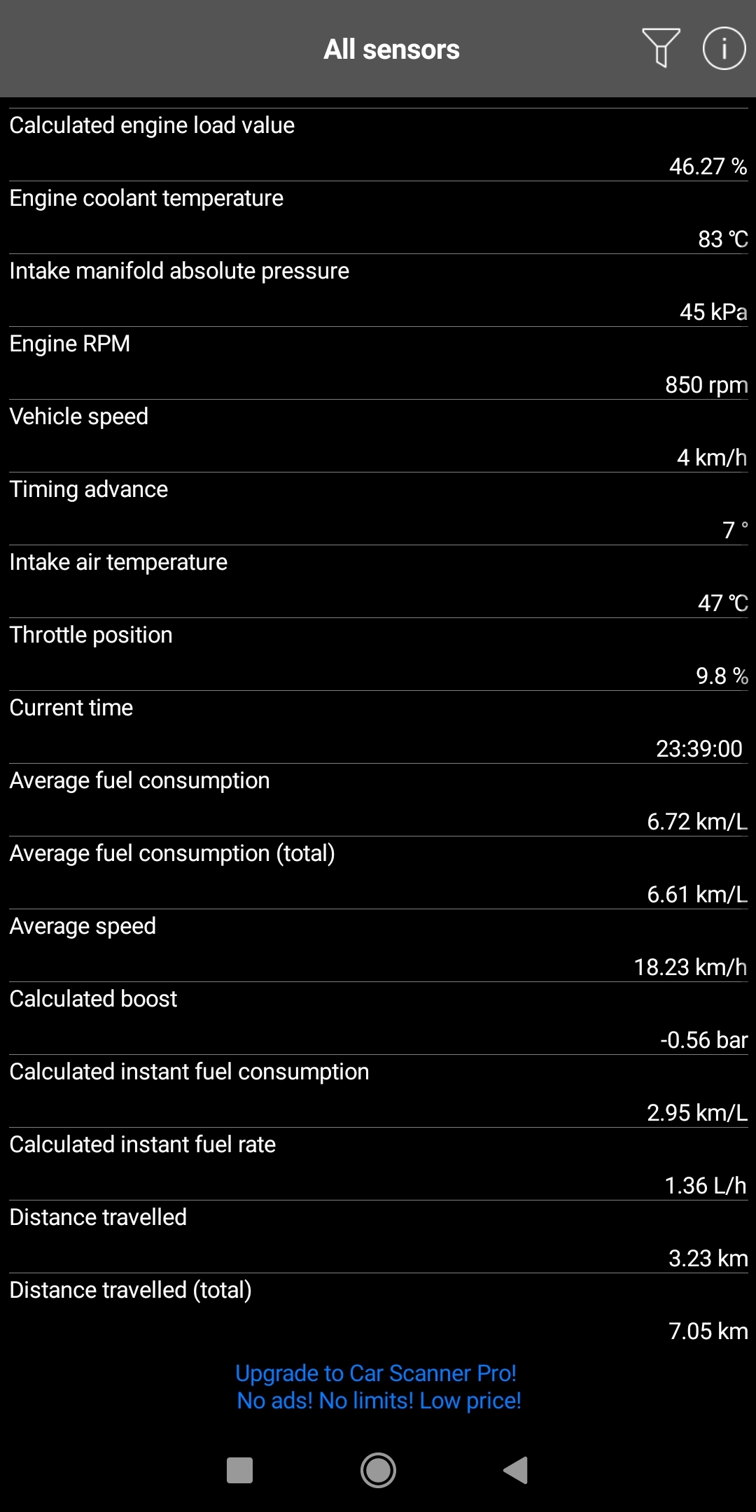

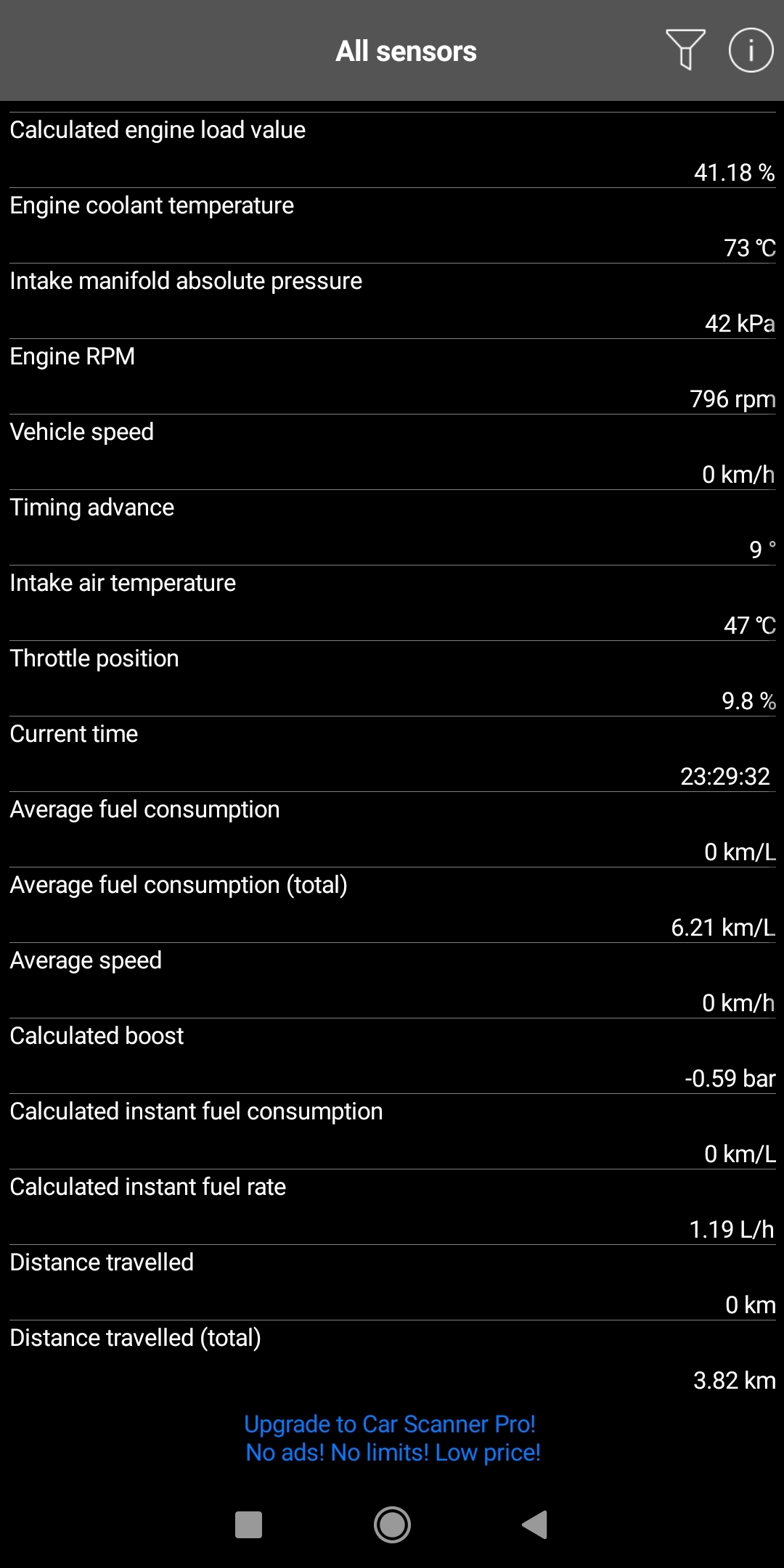

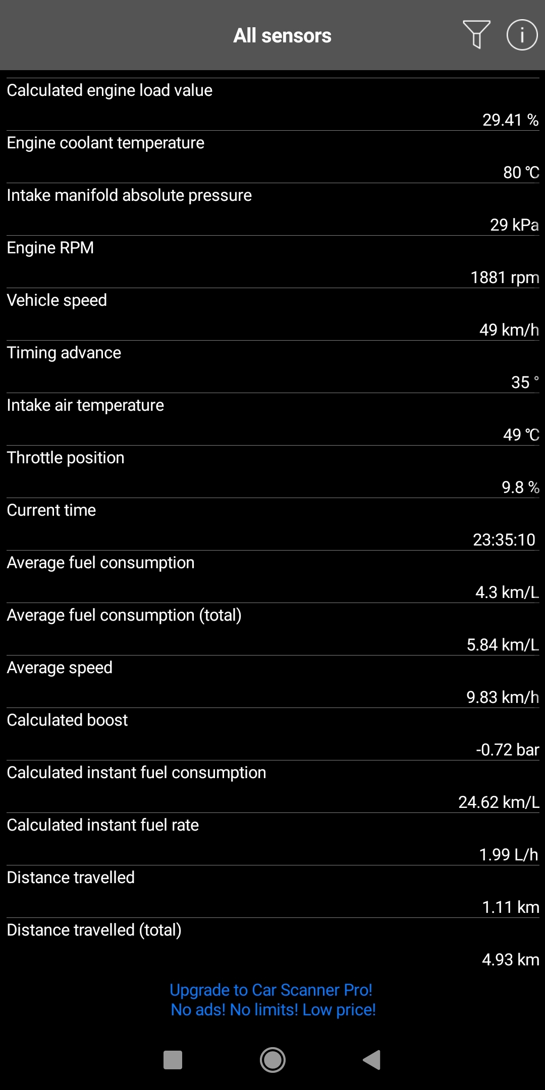

I have bought the obd 2 car tool to check the readings of the sensors as my car is not giving its prescribed fuel mileage for your info i have Civic 2003 exi manual on petrol it gives me 8-9 kmpl with AC in City and 12-13 kmpl on highway with AC. I have changed all the following things
Spark plugsFuel filterFuel injectorTires changed to 195/65/15 with alloysRadiator servicedFan is on autoTappet also adjustedThrottle body servicedPcv valve changedAir filter changed Oil using now 5w30 earlier was using 20w50 but still was getting same fuel mileage so no change from this side.Tire pressure equal in 4 tiresAlignment doneCNG was removed earlier but still mileage is not good.
I am sharing screenshots of the sensor reading please guide me that is every reading is in good shape or not in both cases in ideal and in moving conditions.
@Xulfiqar @hassanbutt293 @HellsGuardian
While driving i run this app and see the timing advance section is keep fluctuating from 0 to 40 which should be in some specific range
8-9 with AC in local is perfect mileage for this car.
Its manual i have see people are getting 11-13 in city with AC and on long 15-17 with AC.
At what temperature fan is kicking in?And share the screen shot of fuel trims.
Fan kicks in on 95 96°C and turn off on 89-90°C when AC is not running. And when AC is on then the temperature mac reaches to 88°C and minimum at 80°C while at high speeds at highway in karachi heat waves.
I dont find fuel trims in this OBD 2 i have checked multiple apps but didn't find value at fuel trim docks.
i think it will show you more data when you click on it not sure.does your condenser fan continually runs?
Yes both the radiator fan and ac condensor starts together when the AC is on and when the AC is off the automatic fan turns on with the running both fans. Because these cars are equipped with wide radiator and ac condenser which need the 2 fan to cool it down
that's why it's running cold. Radiator fan should turn on or gets at high speed (if dual speed) when car gets hot.
But these civics are not have dual speed mode fans they single speed fan when they kicks in they will run at topmost speed
Fans will always turn on when AC is running. Get your Tstat valve checked, it might be sticking in open position. If this was my car, i would stop worrying as this model cannot give exceptional fuel mileage. Most people are either calculating incorrectly or just bragging off
